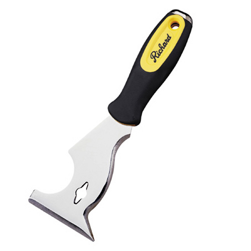

This is the scraper. Used some GUNK engine degreaser - meh. And then I tried my 1200W heat gun on MEDIUM. Definitely worked with new scraper. (See below).
So now I am finished Step 3 and ready for Step 4 tomorrow, assuming the weather is decent(ish)
