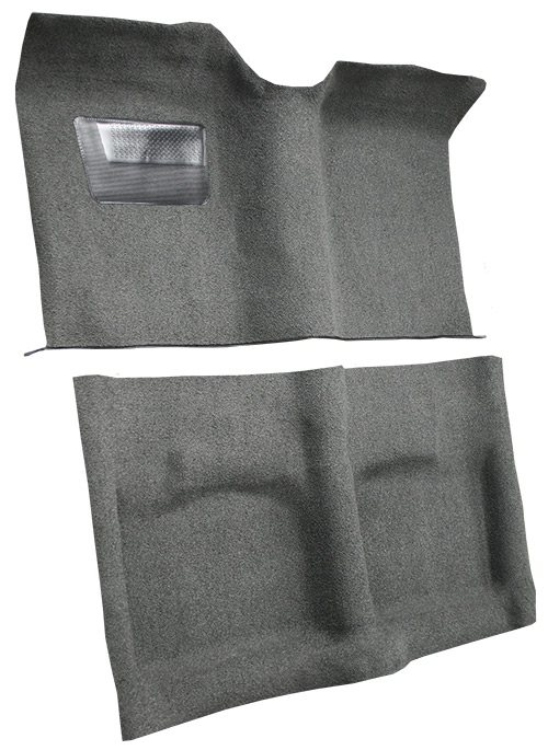

56300B
Posted 2020-02-28 8:06 PM (#594962 - in reply to #590497)
Subject: RE: Lets Talk Carpets
Posts: 480
100100100100252525
Location: The Great Northwest
Don,
I called ACC a few years ago and asked them if they would make a molded set for my 61 NYer and let the rear carpet piece run a foot longer. This would eliminate the need for the two small triangular pieces that are sewn on to cover the space between the back seat and the sill plate on my four door. She called me back and said the guys in the plant could do it but one foot was about the maximum that could be added. The carpet fit just fine and presents a more finished look than the added on extra pieces. I called back and said they could advertise carpets for four door models since it fit very well. It is surprising that they turned down your request for a little extra length on the rear carpet.
Arland
(Molded Carpet R.JPG)
(Molded Carpet 2R.JPG)
Attachments Molded Carpet R.JPG (182KB - 263 downloads)
Attachments Molded Carpet 2R.JPG (186KB - 291 downloads)

I would say swivel seats are bench seats from ACC's point of view. They are bench seats until the driver's or
passenger seat is swivelled for those few seconds of ingress or egress.

I have swivel seats on the 61 NYer pictured above and the carpet is fine. From their standpoint, it doesn't make any difference what type of seat you install on top of the front carpet.
