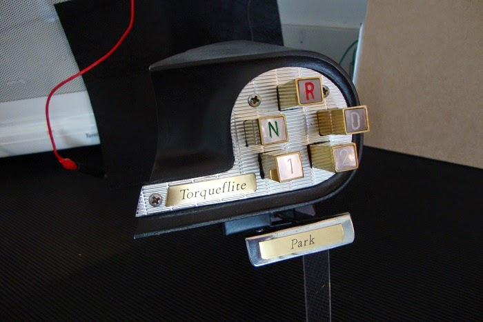

Back in 2014 I played with the idea of modifying a '64 Valiant shifter mechanism to operate the three speed A-727 in my project '56 Plymouth.
I did several mockups and managed to get it to function, but gave up because of the excessive pressure needed to push the buttons. If interested, you can read about some of the ideas I came up with, and also see the '56 Plymouth plate with five buttons and the '64 park lever incorporated in the stock pod. Someday I'd like to take another shot at the idea, but it took up too much of my free time to pursue.

Well I think you did a great job on the Shifter pod:

Many '57-'58 shifters are the same as what you need. The hard part is getting the right buttons. You need those from a '57-'64 Dodge truck and they are hard to find. Next, making the new faceplate to fit the Plymouth is non-trivial. Where did you get the material to make it Gary?

The reason I used the '64 mechanism was to incorporate the Park feature which was part of the mechanism, but there might be better candidates to use.
I bought the embossed aluminum online from a company that specializes in small quantities. The spacing of the pattern is not quite correct to match the '56 OEM material, but it's close enough to not be noticeable. I replaced all the stock material with the material I bought. If you need a small amount, I have some extra.
I made my own buttons from clear Lucite. The are crudely made as it was just a test design and if I had continued to proceed I would have made nicer ones from green Lucite to make them look more stock. The clear plastic makes the lighting a little too harsh. I probably would have also tried to switch the N and R locations, but it would have required a very complex button shape. The letters and numbers were also crudely done by heating steel stamps and branding them in.
The brass sleeve was also purchased online, and the engraved badges were done by a local trophy shop.
It was a fun attempt, and I would like to try again using electronic switching and motion control.
