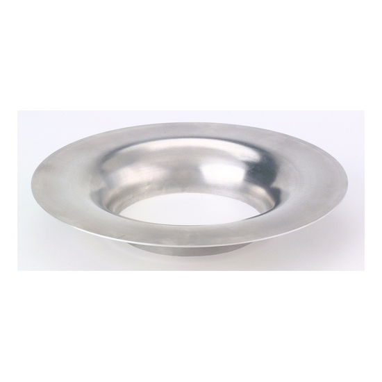

Well, not much to report. But a bit. As I was drifting off to sleep last night, I was thinking about how to make a smooth transition down to the 4 7/32" hole. I had several ideas but the best one was finding a velocity stack that would work, perhaps with some modification.
This is where I am at (plus a little grinding off off those points):
This is what I found on the internet:
Quick Fuel 200-1QFT Carburetor Air Bell, 1.75 x 10.5 Inch
Found one locally in Canada for about the same landed price. Bought it.
Typically, it transitions down to the now standard 5 1/8" carb top, not the 4 7/32" that I need for my D500 WFCB carb. Which creates a bit of a "gap" or "bump" in the air flow.
This is what it looks like, laying loose in the oil bath air cleaner. It will need some trimming height-wise as well as on the outer diameter. I am not sure how to handle the "bump" at the bottom. I also bought a plastic Mr. Gasket 2082, 5 1/8" to 4 7/32" adapter that would cover that gap but it would probably have to be epoxied in place and I am not that keen on anything ( a chunk of epoxy) that could be sucked down the carb. I would be happier if I could find an aluminum 5 1/8" to 4 7/32" adapter that could be welded or pop-riveted to the air bell.
Mr. Gasket 2082 adapter:

It was a lovely sunny day about 10C. My wife was out so I took advantage of that and did the noisy work of grinding the oil bath shell and cutting down the aluminum air bell. For the grinding I used a plug grinding stone on my Bosch 4.5" angle grinder.
This type of stone:
The Air Bell needed to be trimmed on the diameter from 10.5" to 7.5" diameter. I marked the cut line by measuring from the rim of the bell in 1.5" around the circumference. They I cut the bell with my Bosch Jig Saw (and metal blade). I purposely left the line so I can trim it closer after it is installed. Once the bell diameter was cut down, I could measure how much too high it was. It was about 0.5" too high so I marked it at 3/8" and then cut it with a combination of my Dremel and a cut-off blade and a hack saw. I took the line so the actual cut was a bit more than 3/8" (but less than 0.5"). The hack saw was actually easier and faster but I did cut about 25% of the cut with the Dremel.
When I trialed the air bell back in the oil bath shell, it is still a bit too high but that is what I wanted. Then I trialed the Mr. Gasket 2082 adapter in the bottom and then tried the FRAM CA3490 filters, first with one and then with two. I think this is actually going to work.
More trimming, glueing and riveting in the coming days.

With the carpet finally in and the front seat back in so I can drive the car on the street, I decided to go back and catch up on some of the projects that I started a long time ago. That included the conversion of the oil bath aircleaner to paper. So I got back at it the other day.
The first thing I did was to trim the aluminum ring a bit more. I placed it back in the air cleaner and used the black plastic adapter to center the aluminum ring. Then I drilled two holes through the edge of the ring into the air cleaner and installed two temporary self-tapping screws. Then I used the plug stone in my angle grinder to grind the aluminum ring to the same outer diameter as the portion of the OE cleaner below it. Then I removed the ring and touched it up with some hand sanding and/or Dremel disc.
Overnight, I treated the interior bottom with some Evaporust. In the AM, I emptied the Evaprust out and wire brushed and sanded the interior. Then I wiped and vacuumed it out and painted the interior with Tremclad semi-gloss rust paint. I also applied some spot putty to some minor dings in the shell. I let that dry and then sanded it out with 100 and 400 grit sand paper. Then I applied a second coat of spot putty, as needed.
When that was dry I sprayed the outside of the shell with two coats of DupliColor High build filler/primer (sanding with 400 between coats). When the second coat was dry I lightly sanded the primer and wiped off the dust with a blue shop towel. Then I sprayed two coats of Mopar Engine Red (supposed to be very close to the OE D500 red).
Tomorrow I will debate about a third coat of red after I install the inner aluminum ring with some Red RTV silicone and probably six 1/8" pop rivets. I will seal the edge of the aluminum ring to the OE ring with the RTV. The black plastic ring will be installed with RTV as well. In both cases, there will be no excess silicone to come loose get inhaled by the engine.

Carried on with the completion of the conversion.
I place the aluminum velocity stack back in the interior of the OE oil bath shell and used my temporary screws to hold it in place while I drilled four 1/8" holes (of six) through the aluminum ring and the metal lip of the OE shell. Then I pinned the ring in place with 4 pop rivets (just loose) and removed the two screws. Then I drilled the final two 1/8" holes and tried 1/8" rivets in the holes. Looked good.
Then I removed the ring to sand out any drilling burrs and to check the OE lip to make sure that I had caught enough metal (I had).
When I was finished sanding (and polishing) the aluminum ring, I ran a bead of red RTV silicone along the flat of the metal lip, trying not to add too much but also trying not to go too little (There was a bit of both, but easily fixed).
Then I placed the aluminum ring back into the OE shell, on top of the RTV on the metal lip and added the loose rivets again. Then I popped the rivets one by one (I had got lucky and the diameter of the inner filter and the location of the rivets were *JUST* big enough to allow me to get my pop-rivet tool in place).
Then I wiped the excess RTV from the edge of the aluminum ring. I checked the RTV with my portable mirror and found a few spots where I had not added enough on the metal lip. Easily solved: A little RTV on my finger tip, rubbed into the groved and wiped off.
I went around the entire rim checking, adding/wiping as needed until it was all good (enough). Once the RTV sets up, I am pretty sure that there won't be any spalling off of bits.
That done, I laid two beads of red RTV where the black transition ring was going to go. (NOTE: The transition ring is there to seal off the ugly inner cavity of the OE shell that resulted from my removal of the inner "tower" of the OE shell.) Then I placed the transition ring in to the air cleaner and wiped any excess RTV off. I placed a large metal bowl that was handy on top of the transition ring and filled the bowl with water to hold the ring down while the RTV set.
I am not sure if I will do anything (e.g. metal tape) to cover the exposed RTV and the bottom of the transition ring.
I would like to thank Dave Homstad for inspiring me to make this conversion. He had blazed the trail and I just followed (with some deviations).

Since I completed the conversion of the oil bath air cleaner to paper, I have been running the "Ram Air" 413 air cleaner with a WIX 42041 air cleaner connected to the air scoop I made, as detailed in this thread (specifically on Page 3):
http://www.forwardlook.net/forums/forums/thread-view.asp?tid=64475&...
Looks like this:
When the weather turned cooler, I disconnect the hose from the air scoop to the air cleaner and just ran the air cleaner with its new 3" snorkle.
Today (Nov. 10, 2018) I needed to start cleaning out the trunk. This meant removing the chrome air cleaner that I originally ran as well as the paper conversion air cleaner that have been living in separate boxes in the trunk all summer (plus). I decided to finally put the paper conversion air cleaner on for real. As I did so, I tried the WIX 42041 paper element from the "413" air cleaner in the converted oil bath. Nope. The Wix is only about 3" high and the two stacked FRAM CA 3490s are 2.04" each so about 4.1" total. SO If I want a single air cleaner element, I need to find one with a 7.7" ID and a height of around 4".
(Looks like a WIX 42878 would work, i.e. 7.5" ID, 4.25" high, 11.97" OD (might be too big))
https://www.rockauto.com/en/moreinfo.php?pk=578693&jsn=3
https://www.fleetfilter.com/filter/42878.html
I put the converted air cleaner on and took the car for a spin. Definitely sounded quieter than with the "413" big snorkle air cleaner both with/without the scoop. I'll run this converted air bath at least for the winter (if when I take the car out on a sunny day). (The air cleaner will need another coat of red paint in the spring because of the wear marks I stupidly gave it. Duh).
Here is what the converted air cleaner looked like today, installed (complete with a few scratches from being in an open box in the trunk all summer (and fall)).
Edited by 56D500boy 2018-11-10 8:11 PM
