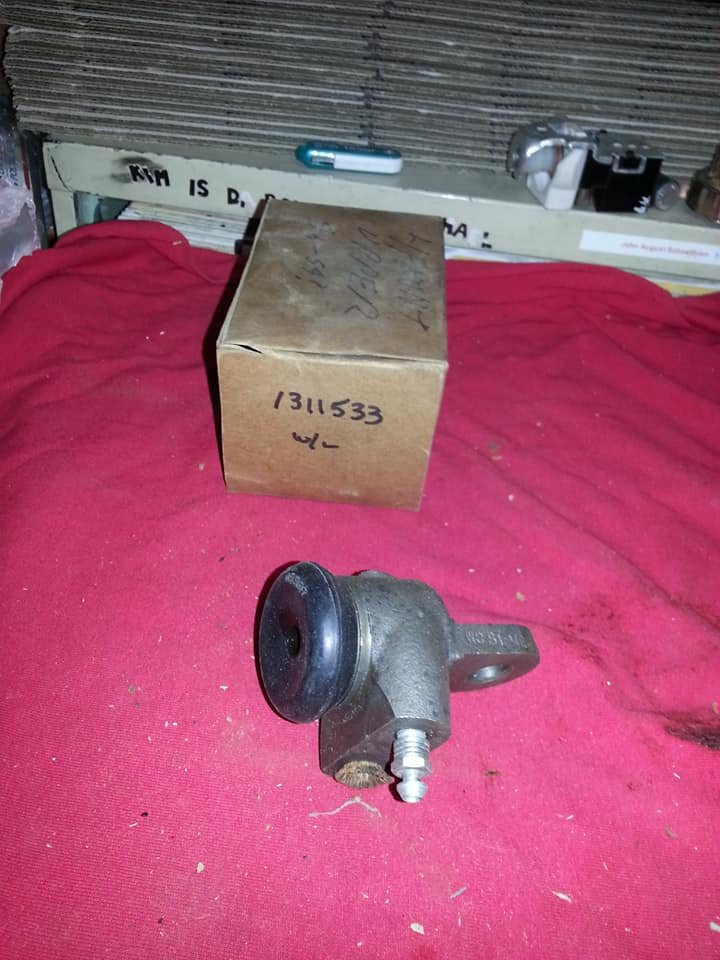

As for the wheel cylinders, it would appear that for 55 and 56 Dodge and Plymouths, they are likely the same regardless of
diameter of the drum.
On that basis, you would need the following:
1311 532 Upper Right Supercedes 1265 942
1311 533 Upper Left Supercedes 1265 943
1265 944 Lower, Right
1265 945 Lower, Left
About 1311 533, Hiltop Mopar says: "NOS Mopar Wheel Cylinder Left Front Upper All 1946-56 DPCD Models"
https://hiltopautoparts.com/product/nos-mopar-wheel-cylinder-left-fr...
I believe Mopar Mall agrees as per their kit:
"Replaces MoPar p/n's 1265942 - 1265943 - 1265944 - 1265945 - 1265946 - 1311532 - 1311533 - 1311534 - 1311535 - 1311536"
https://www.moparmall.com/1955-Plymouth-Dodge-Wheel-Master-Cylinders...
