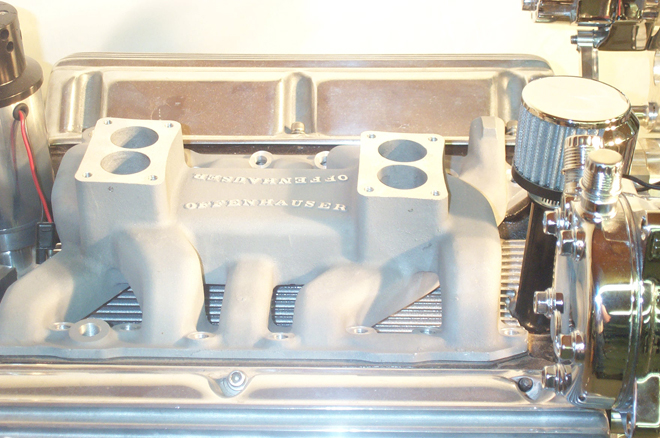

Does this intake fit larger engines?
   Forward Look Technical Discussions -> The Exhaust Pipe - Modification & PerformanceMessage format
Posted 2019-11-28 10:00 AM (#590859)
Subject: Does this intake fit larger engines?
Posts: 6682
50001000500100252525
On Epay: 276 dodge.
https://www.ebay.com/itm/153741437109?ul_noapp=true
I'm cleaning out the garage. Up for sale is NOS offenhauser 1954-56 Dodge Red Ram 241 276 dual carb stromberg 97 intake manifold . I expect to be paid in full within 5 days after the auction ends
(Offen276dodgeintake.jpg)
Attachments Offen276dodgeintake.jpg (22KB - 811 downloads)

Posted 2019-11-28 2:28 PM (#590877 - in reply to #590859)
Subject: RE: Does this intake fit larger engines?
Posts: 3150
200010001002525
Location: N.W. Fla.
"Does this intake fit larger engines?" No, low deck Dodge hemi & hemi based polys only 241/259/270 Won't fit 276, that's a DeSoto.
Edited by Mopar1 2019-11-28 2:29 PM

Posted 2019-12-04 1:28 PM (#591070 - in reply to #590859)
Subject: Re: Does this intake fit larger engines?
Posts: 670
5001002525
Location: Lubbock, TX
Do you mean will it fit the 315-25 hemi from 1956-57? My thought would be no...
Edited by CaprockClassics 2019-12-04 1:29 PM
57chizler
Posted 2019-12-05 1:07 PM (#591117 - in reply to #591070)
Posts: 3855
200010005001001001002525
Location: NorCal
No, the 315-325 are raised deck.
