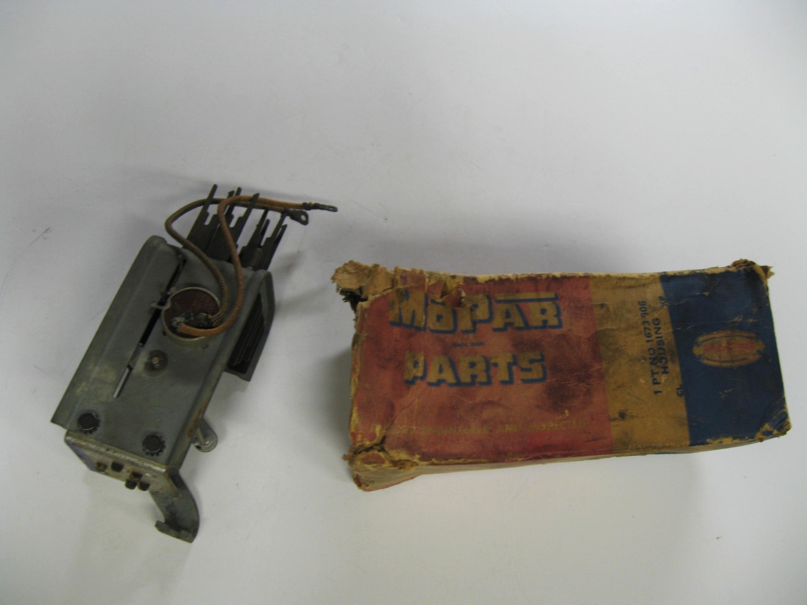

Found a NOS 56 Chrysler automatic shifter box on eBay. PN 1673 906. Searching the 55-58 Mopar Parts pdf for that PN (with Ctrl F = search), it comes up as 56 Chrysler/Imperial only. Then as the year turns to 1957 and 58, there are more PNs for the "same" shifter .
Looks like a 5 button shifter:
1673 906 56 Chrysler/Imperial *ONLY*

(56Chrysler3spdAutoShifterPN1673906.jpg)
Attachments 56Chrysler3spdAutoShifterPN1673906.jpg (223KB - 609 downloads)

Ok here we have two houses for Dodge 56
Left for powerflite mechanism and right for torqueflite mechanism
Look where the detail number is located on the house for the torqueflite. The house is thus cast at the factory and not a modified house for powerflite. In a powerflite house, you can not get in 5 buttons without rebuilding it. The lower (1 & 2) simply has no place. What is strange is that it is the same number as on the house of powerflite.
I think they did a lot of expriment and special things that were not documented at the time.
(22.jpg)
(3.jpg)
Attachments 22.jpg (154KB - 571 downloads)
Attachments 3.jpg (124KB - 603 downloads)

There is a part number 1694 290 listed in the parts book - push button housing (in prime) for the 1956 Dodge with Powerflite. Nothing for Torqueflite in 1956.
The housing for Torqueflite is listed in the 1960 Dodge Truck parts book (do not have 1956-59 truck parts books) as part number 1666 611. Again, in prime.
As the two housing are not identical, a unique part number was assigned to each style.

As per Dave Homstad's instructions, I suspect that the four-eared 1694 290 housing is factory stock and the two-eared version has been modified by someone:
Dave H. said:
"4. I found that the original PF button housing on the dash had 2 unused threaded ears at the bottom of the front opening. These may have been intended to be used for holding the cover plate, but never were. These lower ears will interfere with the "1" and "2" buttons. Cut off these lower ears, being careful to leave the rim of the opening for mounting the cover and not to mar the outer paint finish. I used a hacksaw blade held with a pliers to cut the soft pot metal."
REFERENCE: http://webpages.charter.net/dhomstad/TransmissionFrame1Source1.htm
